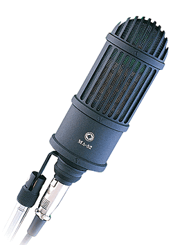

The ML52 is made in Russia by Oktava, and is supplied in a foam-lined ABS case. It is a substantial black beast measuring 185mm in length and 55mm in diameter. It weighs 600g, but looks a lot heavier, with its matt-black metal body and vertical grille fins. A threaded stand adaptor fits around the XLR connector at the base of the mic.
Like any ribbon mic, the ML52 must be treated with care. Air blasts -- whether from wind draughts or an idiot puffing into the mic to test it -- can easily stretch or rupture the diaphragm.

The ribbon is a corrugated double-filament affair about three microns thick, open to the air on both sides, through the substantial magnet assembly. The polar response is figure-of-eight, and it remains very consistent across most of the frequency range, with rejection at the sides reaching 20dB in the mid-range.
There are no active components in this mic, which is why there is so little self-noise, but also why the output voltage is relatively low. Having said that, the mic's sensitivity is 1.6mV/Pa, which is about 10dB higher than that of the classic Coles 4038 ribbon. The signal level is similar to that of a modern dynamic mic, although still about 25dB lower than that of most capacitor designs. The quoted maximum SPL is over 135dB, so there should be no fears about putting an ML52 up in front of a brass section.
Although it is often suggested that phantom power should be kept away from ribbon mics, in practice I've never had any problems, provided properly balanced circuits are used and the mics are connected with XLRs. Never plug or unplug any mic via a jack-plug if phantom power is on!
The frequency response of the ML52 is quoted as 50Hz to 16kHz ±2.5dB. Although pretty flat from below 50Hz to 5kHz (albeit with a broad 2-3dB lift at around 150Hz), there is a substantial hollow in the response above this. The wide dip stretches between about 5kHz and 16kHz, reaching almost -6dB at 8kHz. Although this looks alarming on the supplied chart, it translates into a smooth and mellow sound, which is characteristic of the breed.
Like most figure-of-eight mics, the ML52 has a substantial bottom-end capability, and is extremely sensitive to every rumble and vibration which finds its way up the stand or cable. I would consider a shockmount absolutely essential and, while no dedicated unit is currently available, Oktava's worldwide distributors say that one will be on sale within a few months.
